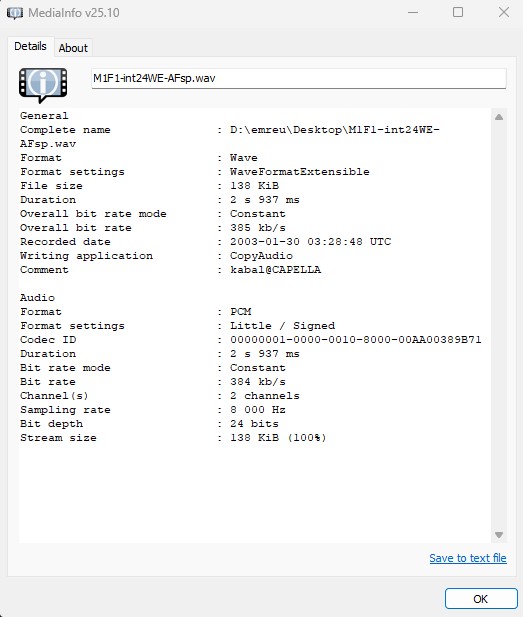

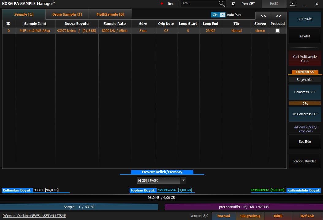

Hello, the locked set I purchased for the Pa5X contains 24‑bit samples. When I open the set in the sample manager, the samples appear as 16‑bit, and when I add a sample and save, my keyboard no longer opens my locked set. My locked samples become unusable. When I create a new set and manually import a PCM wave file that I am sure is 24‑bit, it also appears as 16‑bit or is automatically converted to 16‑bit.

The PA5X Does NOT supported 24bit samples. Everything gets converted to 16bit and PA Manager only replicate that.
