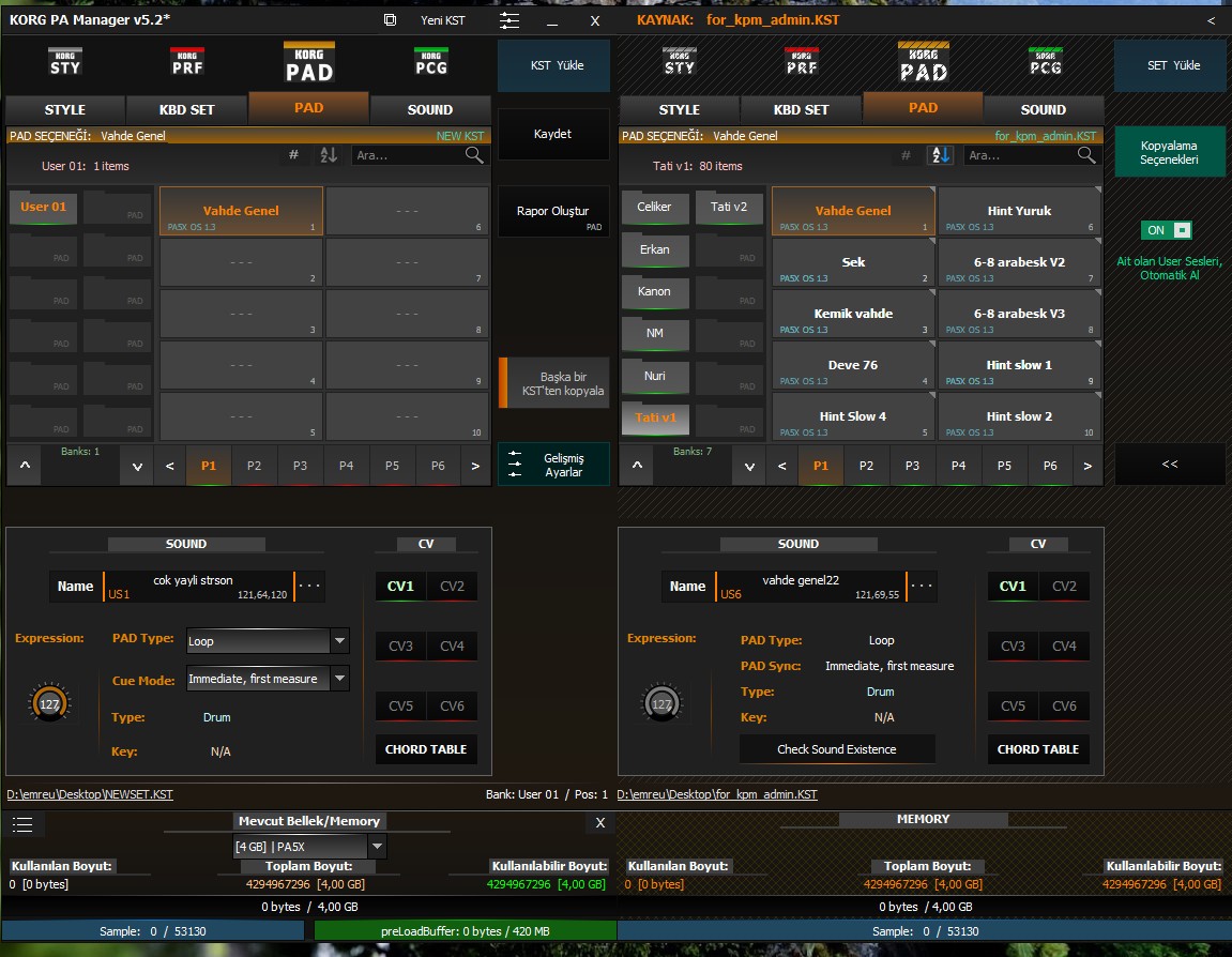

I did what you suggested and yes, I saw the issue as you described. However, there is one point I do not understand: is the pad now embedded into the rhythm? I thought it only referenced the pad section. I have attached screenshots of both the pad linked to the rhythm I wanted to transfer and the pad I saved as 'Save As Pad'. I would appreciate it if you could clarify this matter for me.
Ekran görüntüsü 2026-02-20 094005.jpg (242.16 KiB) Viewed 99 times
Posts: 941
Re: It captures even the sounds that are not used in a rhythm or pad.
With the PA5X, the PADs are now embedded inside the Style, just like a KBDSET. They have no reference to the PAD section or separate PAD files.

Thank you for your response. As far as I understand, at the moment there is no function in the software to edit a pad that is embedded into the rhythm. We can only edit it after saving it as a pad. However, the pad that is embedded within the rhythm is still considered as not edited.
Posts: 941
So you need to extract/save the PAD out of the Style.
Do your Edits.
And the reAssign the updated PAD on to the Style.
