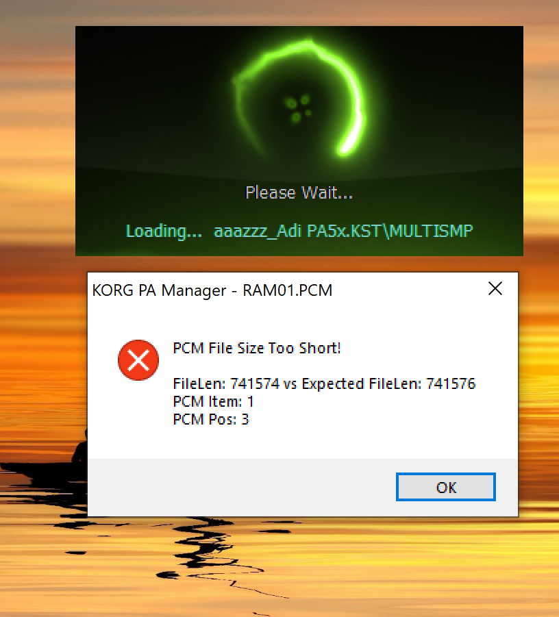

This is just one: ImageI tried adding stereo samples to a set of PA5x and saving the set. When reopening the set I get this error.

adriandoru wrote: 10 Oct 2023, 12:28 This is just one: ImageI tried adding stereo samples to a set of PA5x and saving the set. When reopening the set I get this error.
That is one error it seems and NOT too many as the title suggests.
Anyhow, we will take a look and fix it for the next update.
We cannot replicate this problem with any of the Stereo samples we have.
Can you send on of your .WAV examples to examine ?

Posts: 929
Re: Too many errors
Thank you for attaching the .WAV to test, but there seems to be NO error, when you import the wav, save it and reLoad it again.
Can you try on your side to confirm the problem happens?

Posts: 929
Re: Too many errors
Does it still happen if you select and import just 1 wav file?
