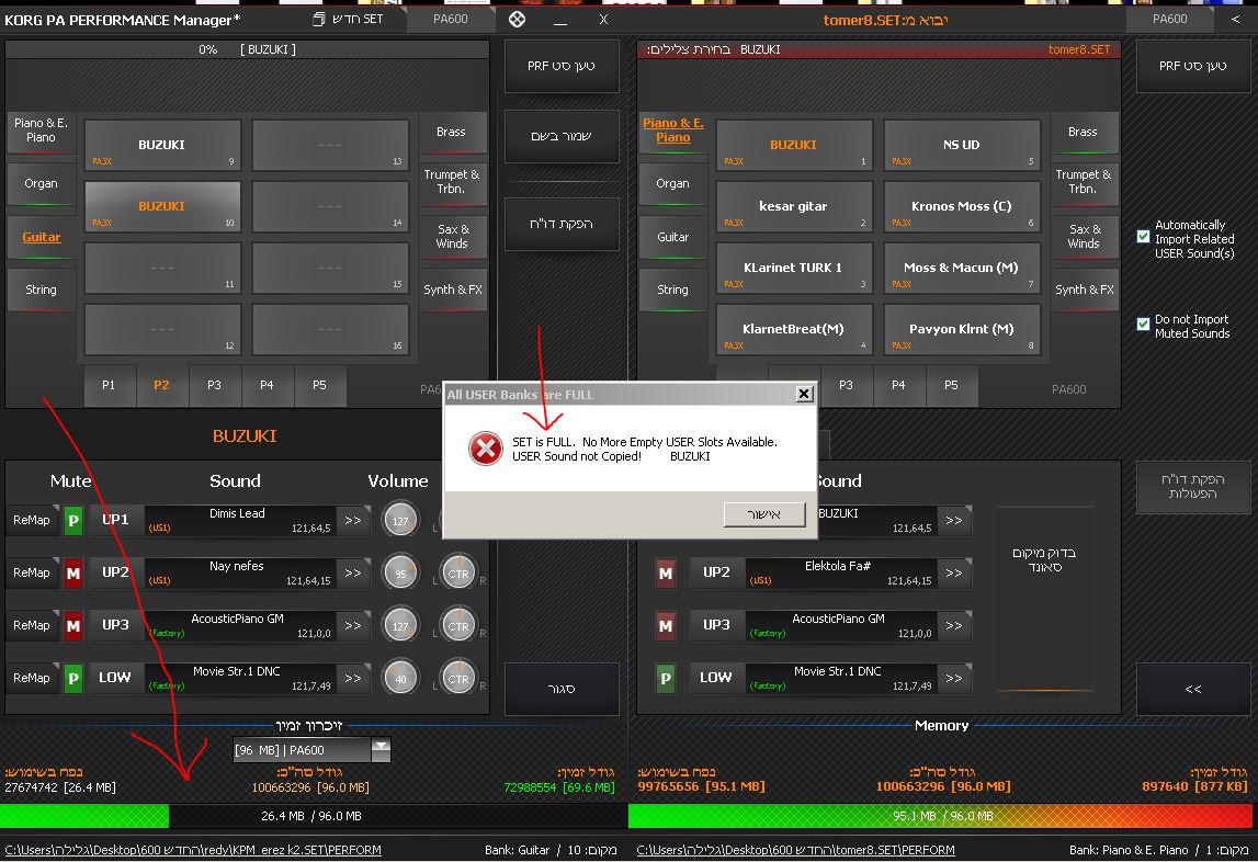

im trying to do a set to a pa 600
and when i try to copy a perf...
it says that there is no space

You seem to be confusing the available MB with USER SPACE location.
If you read the Message carefully, it states the the USER locations are Full. (User1 / User 2 etc..)
All 128 Banks have been filled and there is no more space to add any new sounds.
