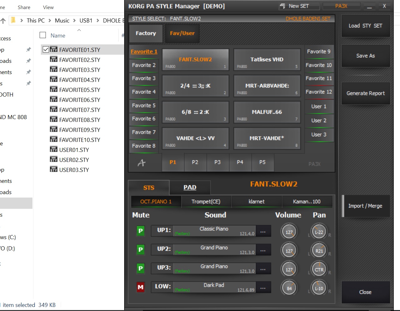

Hi mate, thanks that’s great that you can transfer the license and secondly I was checking the demo software and have taken a screen shot but I don’t understand how can I listen/preview the sounds and manage them without my 3X? Also how can I listen to the style in style mode? Can you kindly explain to me in detail.
Lastly please tell me in the future when I connect Manager with 3X will any changes that I make in Manager be applied all the way through to PA3X ? Actually in my studio I already have Yamaha MOXF and any changes I make in its editor automatically is applied in to the keyboard so does Manager work in the same way?
You cannot listen/preview the Styles, but you can listen to the individual samples via the SAMPLE Manager. (videos on the website)
I think you missed the point on the previous posts.
The software has no direct integration / interaction with the keyboard. It never connects via a midi / usb etc.
Any changes you make, will be saved out a .SET ( which contains all of your styles, sounds etc..) You then copy this folder on to a USB Pen Drive and re-load it on to your keyboard for changes to take effect.
