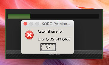

First, I just wanted to thank you to help me to install V3 on my iMac.
Second, after trying to merge a style from one Set to another Set, I got an error message, see please screen shot.
What I did when I got the Error message:
I just right click on a style from a set > Copy.
Paste to an empty slot to another set (got the error message at this step).

Hello,
Report of V3 Upgrade:
1- It's very slow (Style Manager) from clicking on Style Manager until it opens the window to choose a set folder.
-That's something dependant on your Mac speed.
2- It did freeze on Copy/Paste from one set to another.
-That's something dependant on the SET/Style.
3- Very Important: After trying several times and getting the above error message I saved the merged set to a C.SET and I load it into my Pa4x but I noticed it erased/deleted all Users DK (all 16 pages) from my A.SET and it did not copied the UDK from other B.SET into C.SET.
I found all slot Empty.
-You saved the SET as a NEW SET right? And didn't overwrite over the existing one?
Also check the SET again with the SOUND Manager to make sure if the DK's exist.
From what I gather, the SET contains 4X OS V2 sounds, but your OS is 1.2.1 So the 4X perhaps didn't load any of the DKs.
4- The OS in my Pa4X is 1.2.1, never upgraded not tried to version 2. When I first opened the A.SET, it detected as OS v1.2 but later after closing the Korg Pa Manger and tried it again, a window pups up and asked me the destination Pa version with two OS options, OS v1 and OS v2.
Obviously I would choose OS v1 BUT it only let me to choose OS v2. Not possible to choose OS v1.
-So here you've copied something from another SET that was for the OS V2 so that's why it's detecting it as OS V2.

Admin wrote:Hello,
I don't think so. I give the specification of my iMac as a screen shot and you will see that my iMac is fast enough for running the Korg Pa Manager.
I run with the same iMac the software like Logic Pro X with using VST, Cubase LE 8, Sibelius and Photoshop 6 without any problem.
Specification of my iMac:
OSX: Mac OS Sierra version 10.12.6
iMac: 21.5 inch, Mid 2011
Processor: 2.5 GHz Intel Core i5
Memory: 24 GB RAM memory
Graphics: AMD Radeon HD 6750M 512 MB
HD: 500GB
Could you explain more in detail what exactly would be the reason in SET/Style for freezing the Korg Pa Manager but not freezing the Pa4X when loading the same set and working without any problem.
Yes I saved the SET as a NEW SET.
If you are talking about A.SET (which I use for one year and half made with OS v1.2.1), then of course all DK's exist.
If you are talking about the B.SET, I have loaded and test in my Pa4X (OS v 1.2.1) and of course all DK's exist and they play correctly.
If you read carefully my previous statement no 4, I clearly explain that the problem is with my A.SET (my working set that I use every day) when opened in Korg Pa Manager, it is detected as OS v2 and it is made in OS v1.2.1 and working with it for about a year and half.
Please fix these bugs because I waited longtime for the previous bugs to be fixed and I couldn’t use the Korg Pa Manager for my projects.
This time I upgraded to V3 Upgrade with the hope that I am getting a working version of the Korg Pa Manager.
With all due respect.
