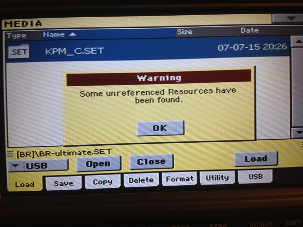

I could combine my styles to a new set with their relative sounds. It worked fine for almost all of them except 2 styles that they do not sound correctly despite of remapping their Users/UserDK. After finishing completely my project (combining 2 sets), I saved it on a flash drive and loaded into the keyboard.
Everything went smooth except I got a message on the keyboard after it finished loading the new set. I attach a screen shot of the message.
Is this message could be related with 2 these style that don't sound correctly?
I would appreciate it if you can help me to import correctly these 2 remaining styles and finishing my project.
Regard

Posts: 910
Re: No Reference to Sample in PCM
Perhaps those 2 Styles are referencing the DK that has some unreferenced samples, which is why you are seeing that notification.
All other Styles work ok, right?
Best Regards
Do you mean these 2 styles are missing some samples? I just precise that these 2 styles play correctly in their relative set without any problem.
Yes, except one style that didn't play the right sound in PERC Track (It was correctly remapped to the right sound according to the Sound Report in Pa Manager) and then in the keyboard I had to replace it with another pretty similar sound and now it sounds correctly.
