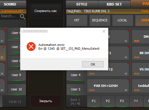

2. When I try to listen (play) in PA Manager - it gives an error !!!
s00000000000000
Automation error
Err @ 1240 @ SET__OS_PAD_MenuSelect
https://i.yapx.ru/LkRai.png
Скриншот 24-03-2021 215306.png (32.07 KiB) Viewed 15584 times

Hello,
1) You will need to clarify this please. What doesn't seem to work?
Have you checked the Sounds & Samples used? If they're missing? More info please....
2) Can't initialize your Sound Card Device. Simple fix, is to re-install KORG PA Manager.
VitaminP

After reinstalling PA Manager, everything started working! :-)
