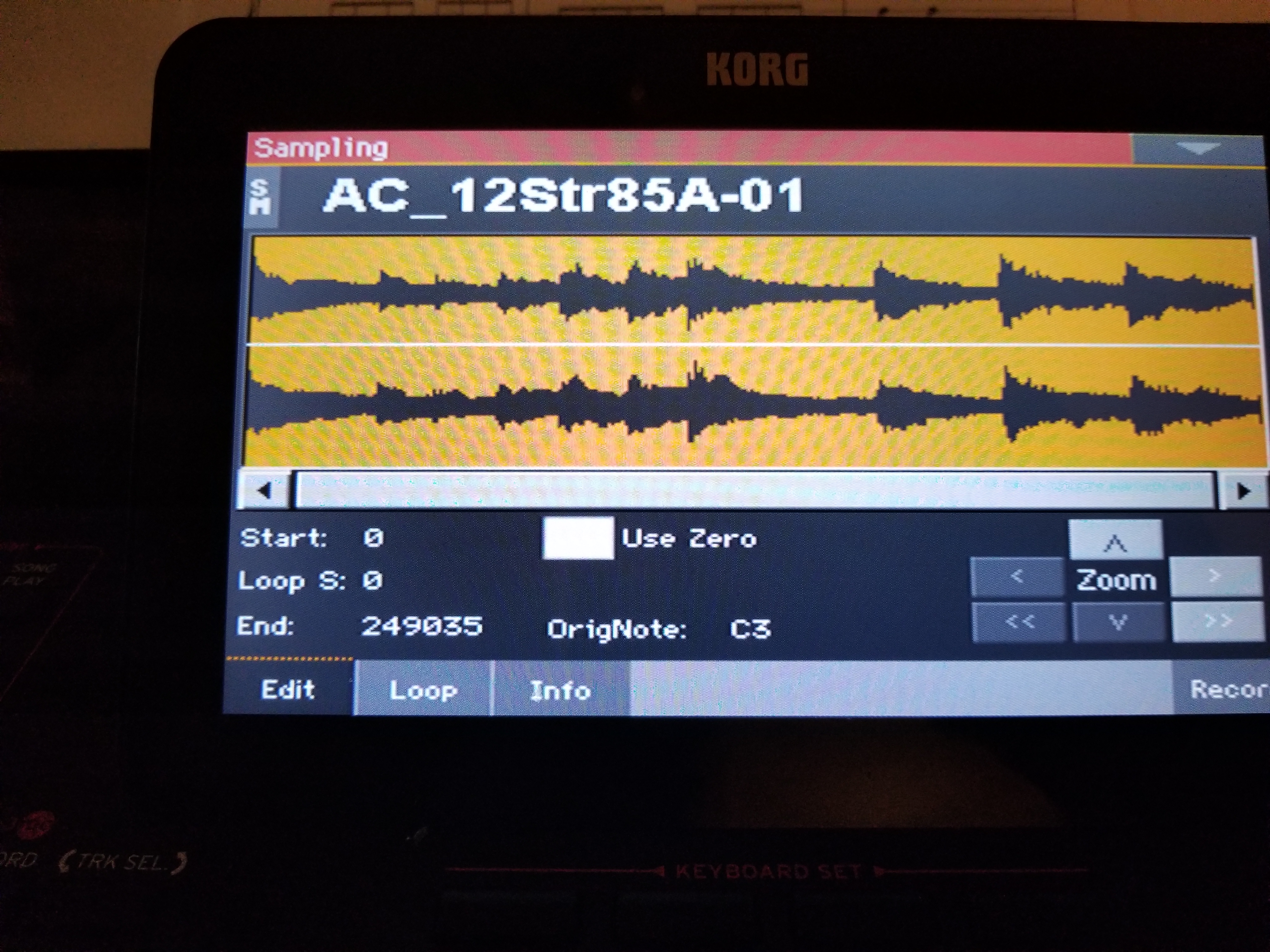

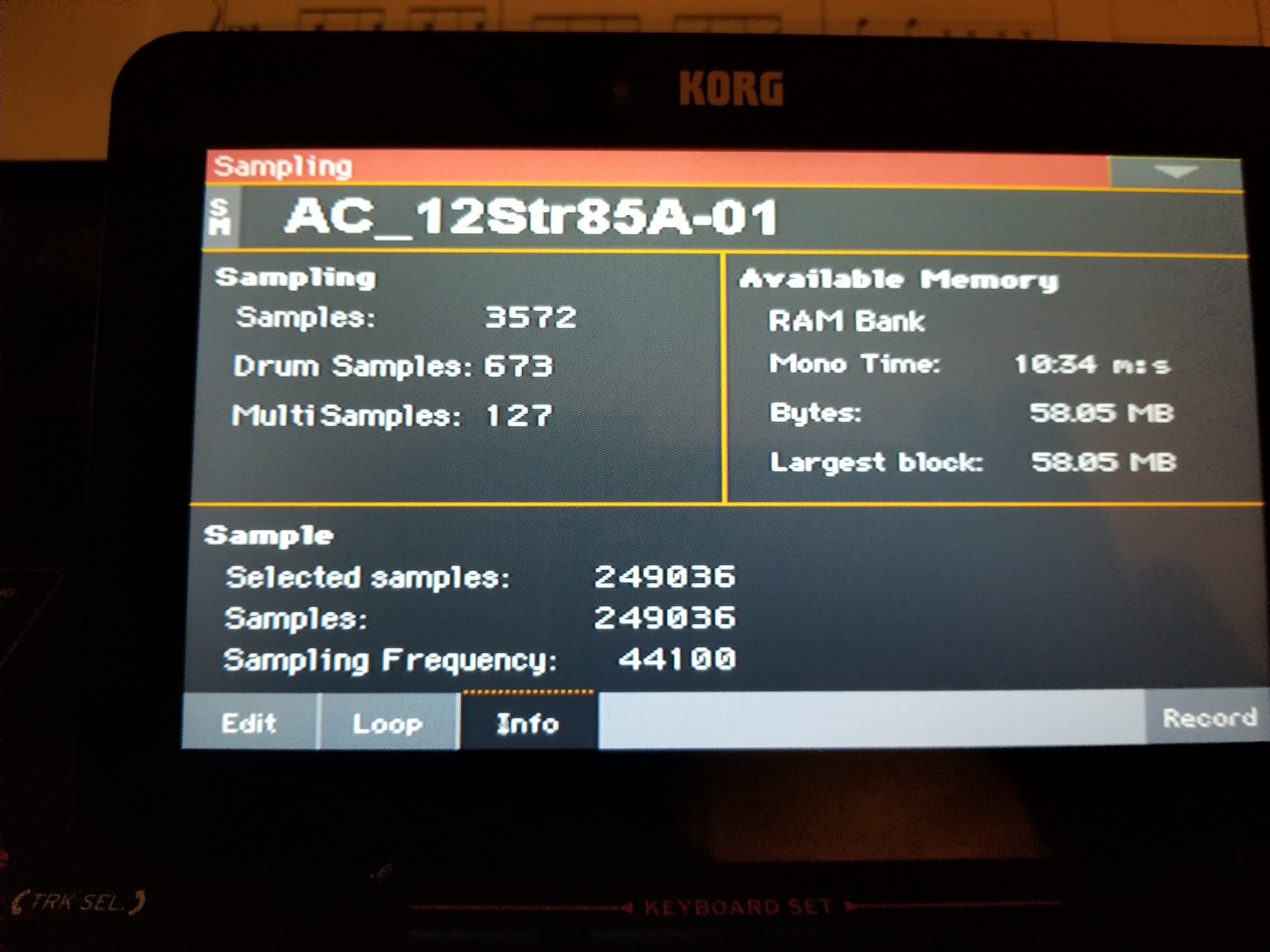

What confused me was that I was able to load both of the samples into the Pa4X via the touch screen menu. I had not read that section of the manual yet. Both of the samples also sounded good when played via the keyboard. I did not realize that it was truncating the longer sample though. Here's some screen shots that show the loaded 24-bit sample.
I will convert them to 16 bit and truncate the longer ones as suggested.

It seems the keyboard is converting the 24bit to 16bit and trimming the other one.
Perhaps the software could do the same in the future.
