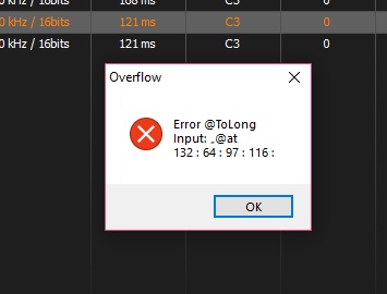

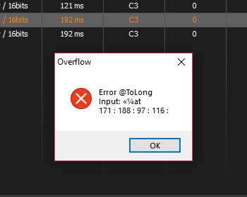

Hi.
Sometimes importing .Wav files i get this error "Error @ToLong"... .Yes, KPM loads them and there are no problems. Just curious what this means?
I have tried many different variants for samples (even without any adds in file like genre, name etc.), but sometimes anyway this message comes out.
I import normally 48kHz or 44.1kHz 16bit samples.

Posts: 865
Re: Imporing Samples (Drum)
Hi
That shouldn't be a worry and still imports the .wav normal as you've found out.
It seems something todo when it reads some data that exceeds some limit.
Can be ignored for now.

Posts: 865
Issue has been resolved with update v3.3.6410
