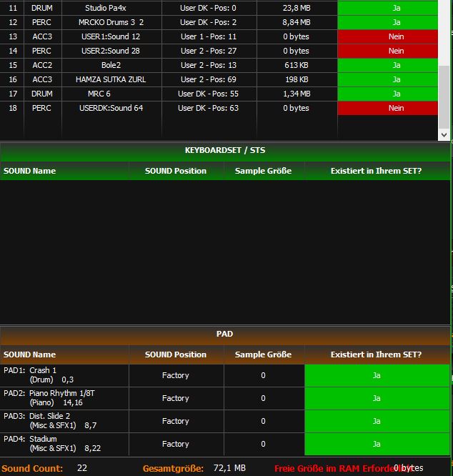

Hello, if I copy a style and then go to collective size, I see that some sounds are missing. Can I somehow find out where the sounds are in which other style? For example, I would like to copy only 10 styles from a set and not all of them.
Many Thanks

example

PAmusiker wrote: 02 Mar 2021, 20:03 Hello, if I copy a style and then go to collective size, I see that some sounds are missing. Can I somehow find out where the sounds are in which other style? For example, I would like to copy only 10 styles from a set and not all of them.
Many Thanks
In SET Manager, click on the SOUND Tab. Locate the sound and right click> Search where this sound is used. This will scan and show you where that Sound is being used.

WOW ! Perfekt 👌 Thank You 🙏
